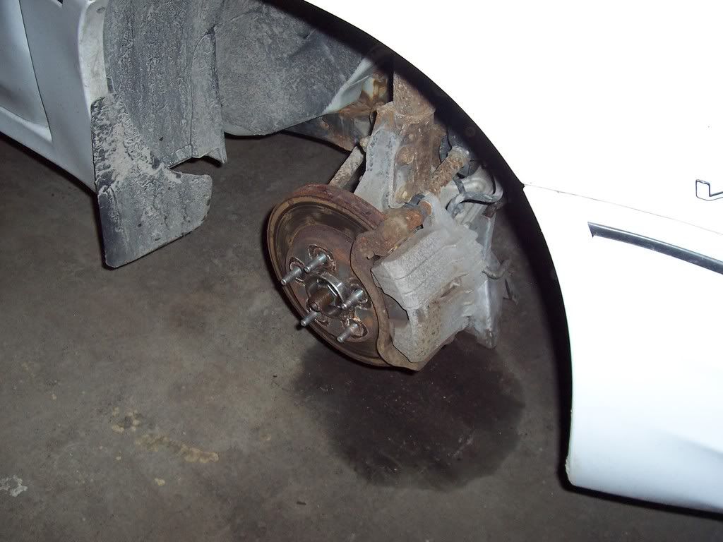

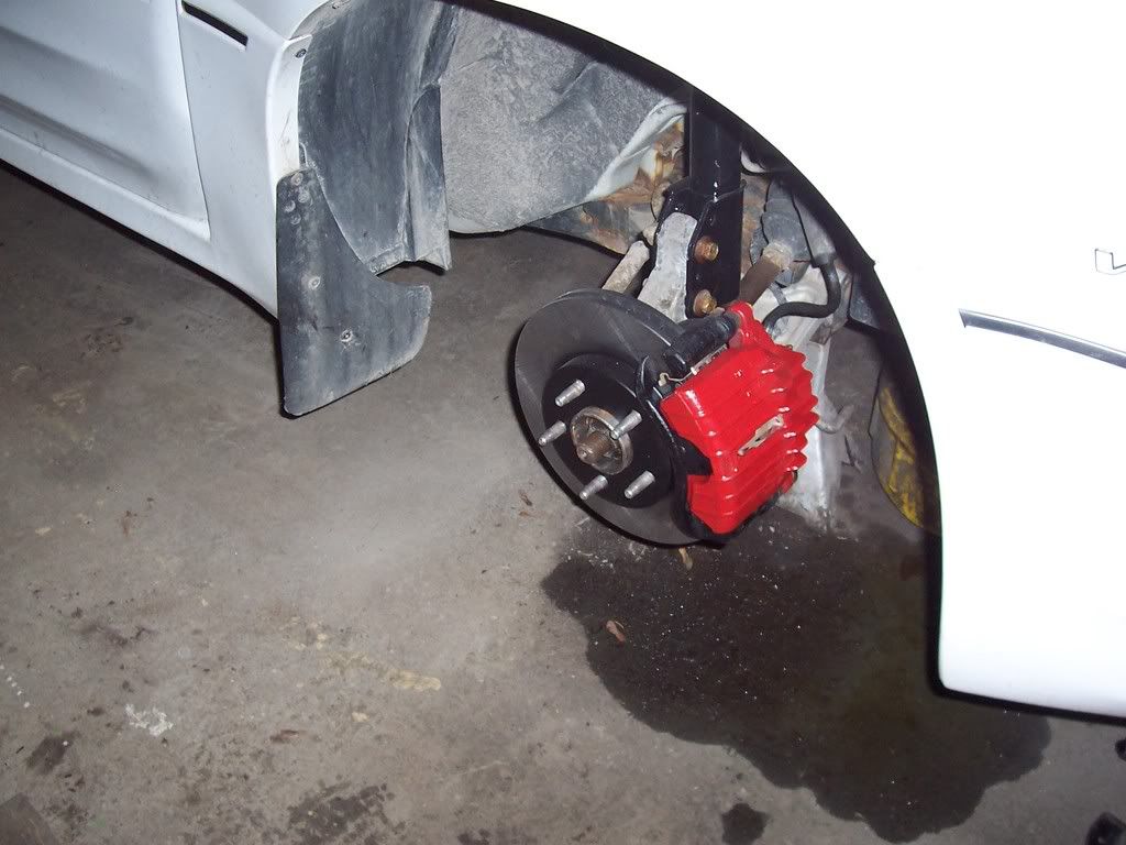

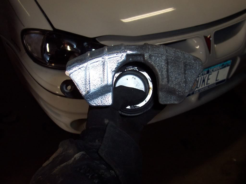

Does any one know if there is way to upgrade the rear's on the GAs disk setup? I saw a bunch of people ask in this thread but did not a response or positive No. I am going to try to make something work but I wanted to know if any one else got it to work on the back. I am definitely going with the Gray up front.
I did the Red Caliper and the Black Bracket and Rotor hub. It turned out good and lasted about 2 years with moderate cleaning to keep them nice and Red. There is nothing wrong with them I am just sick of looking at the Red.
Oh and I used my original Calipers. I would rather paid for new ones (Vette). Six hours of a wire wheel, wire brush, and good old fashion muscle to transfer all four Calipers to a clean base.
Just a little bit of oxidation, huh?
