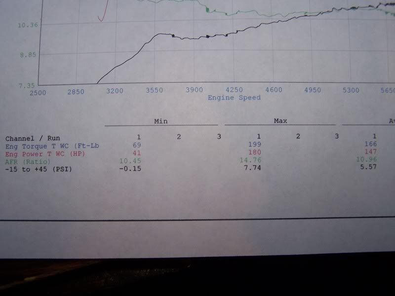

the diff in dynos doesnt mean your making more power or not, they just measure differently and generally yield higher numbers on one.....
the a/fs are terrible... a 14.x at wot is the problem
The 14.x measurements weren't at WOT.

Not horrible for a narrow band if you ask me, should be getting a wideband soon. As long as the KR is gone/low and I'm not going lean I'm not too worried atm.

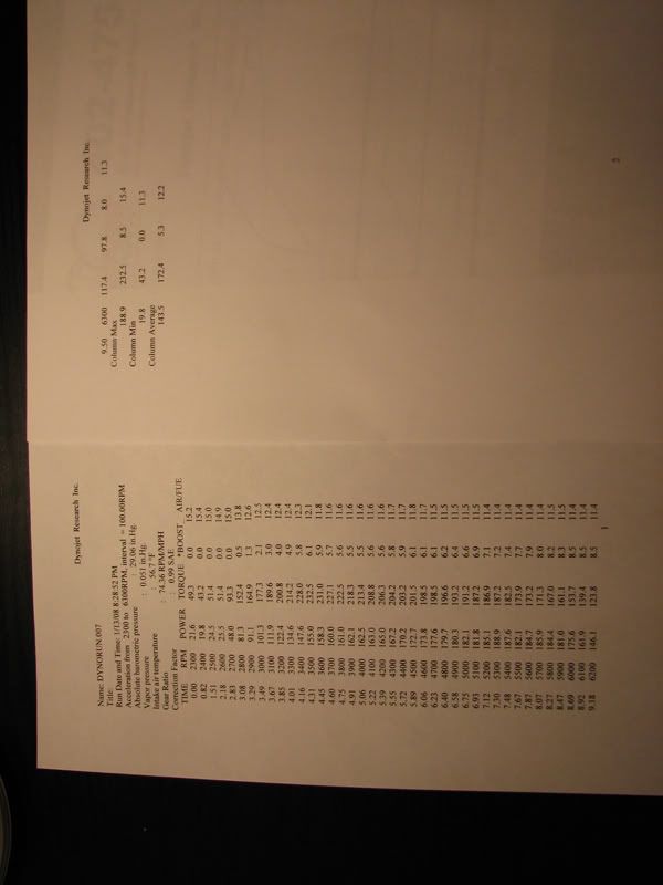

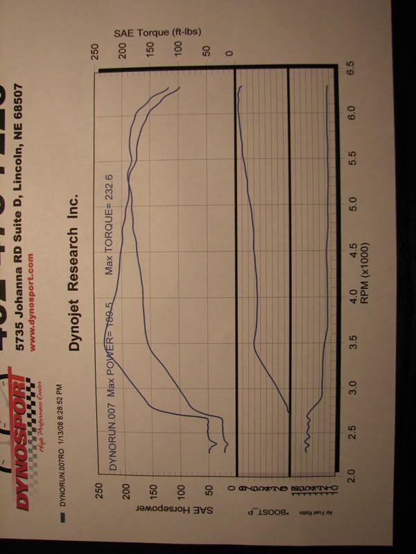

Old 01-13-2008, 11:19 PM   #38
angrysk8r
AKA: Luke
Location: Lincoln NE
Posts: 331
Vehicle: 1999 Grand Am SE
angrysk8r Gettin' there
Here's the new results from the dynojet. I scrounged up some money and did an hour of dyno tuning while I was there too. Before the tune I was getting around 210 max torque and 185 max hp. After a few afr changes the scan below ended up being the best without KR popping up. I tried messing around with the wastegate a little to lessen the boost creep (need to port the ****ty internal wastegate/make a bigger DP) and got 201 max hp but the overall torque and hp was lessened so I went back to the way it was before. Overall it's about what I expected I'd get from the budget project and I'm pretty pleased but still have a ways to go before I'm completely happy.

ha. sweet torque. i imagine it runs better now?
