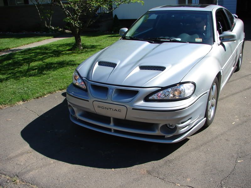

Does the H1 or H2 bulb need a different ballast? or can i just buy new bulbs and use the same ballast
You can just get bulbs w/o ballasts...

my only thing i dont like is that the angel eye is very dim...but i guess its kinda good.

100% both bulbs are H1s.

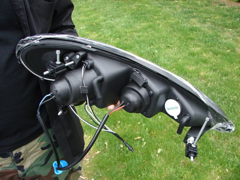

so did you dremel anything to get them to fit in there like that or what is direct bolt on???

all bulbs are H1s. the 194 bulb that is in the middle of the stock headlight runs the halos. and the 3157 and outer 194 stay the same.
as for dremeling, i widened the square where the "pain in the ass clip" is. you know the metal clip that you need to push down to lock them in. there is a square there, i just rounded the edges a little more and widened in and they went in. be for warned though, these are a pain in the a$$ to get in there. took me about an hour to get both in...im usually good at getting the lights locked in too....i get my HIDS this week. after the install, i will take some more pics with the light difference.

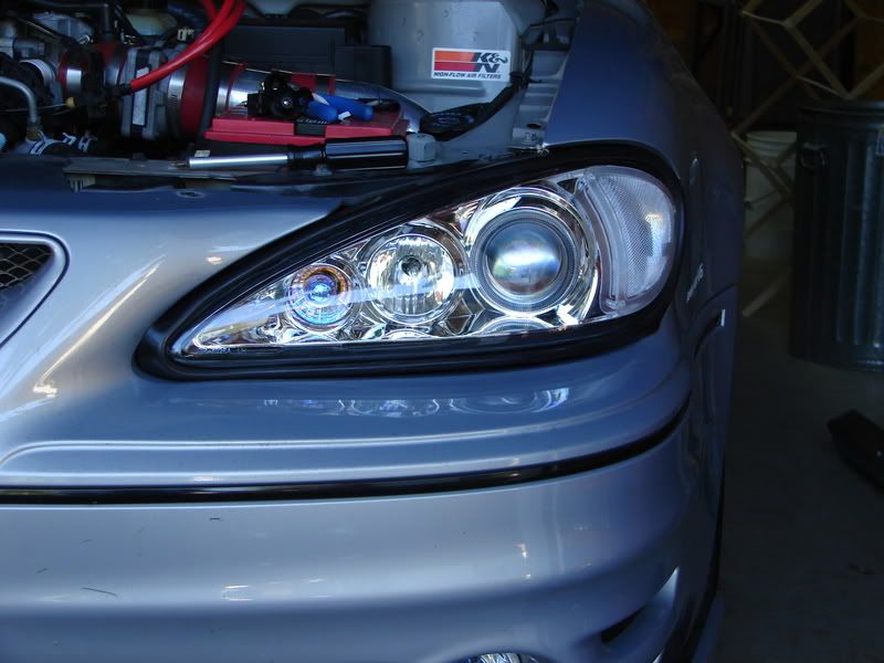

i didnt dremel at all and mine went in pretty smooth..the projector "line" you get when you aim them is kinda weird...it makes a "check mark" kinda look...

i had a 9007 HID kit with my original lights. i just went on ebay and bought a H1 HID bulb set. ran me another $40. and plugged the H1 bulbs into the ballasts and it works perfectly fine. the lights just need a little finagaling to get them in there. we had to dremel just to get the hole a little bigger.

post a ebay link where u found those H1's please...and what temp color u get? 6k i hope? =)
and have u aimed ur headlights yet? do you have the ____/ look on them?

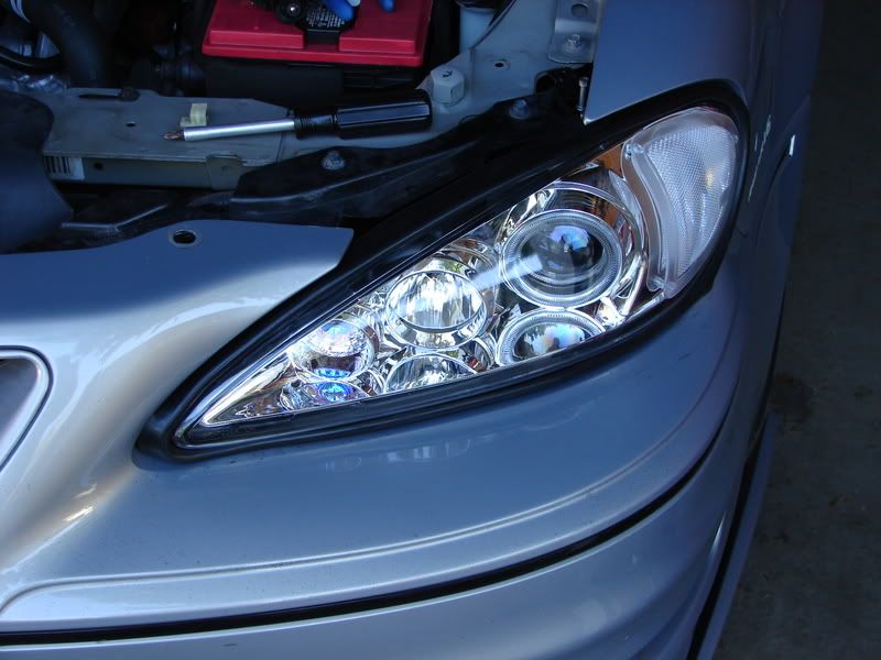

^ ya kinda like to see the light output at night all aimed

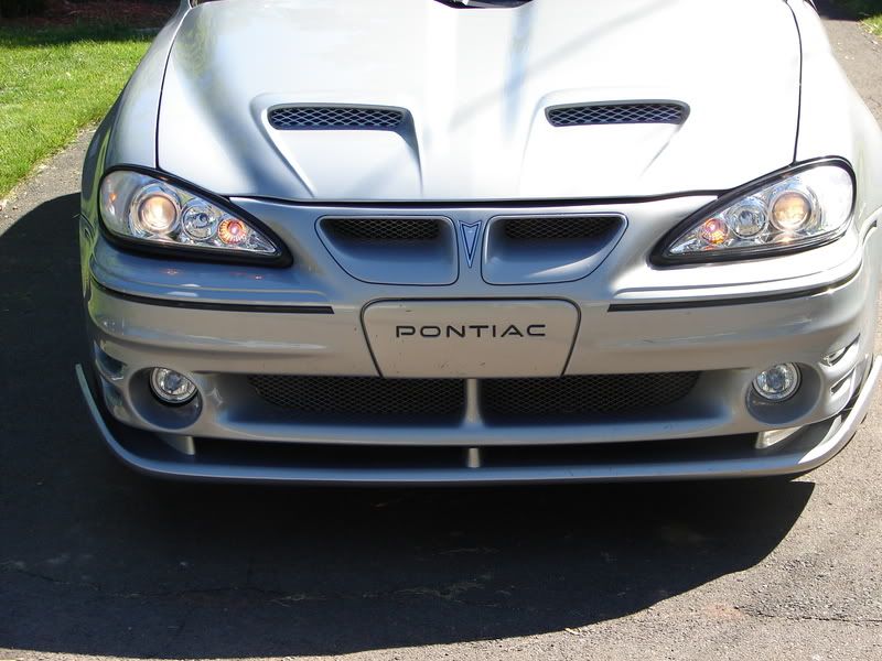

i did get the bulbs in 6k. you just have to make sure what type connectors you have off the ballast. i have amp connectors which is what is shown in the picture. some kits come with universal plugs.
