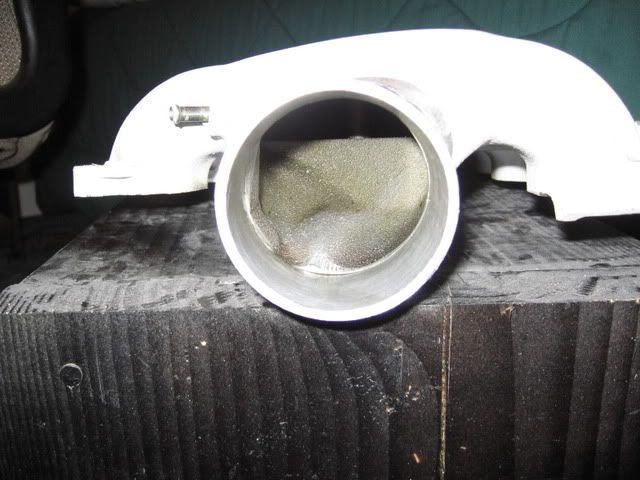

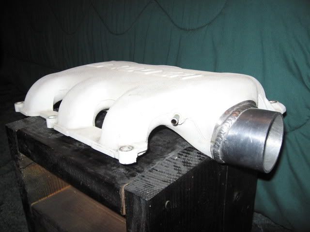

While I'm at it, here's some shots of the IM:

Old 11-06-2006, 02:16 AM   #77
Whoa...cool. What's the diameter of the inlet?
Old 11-06-2006, 06:32 AM   #78
Sprucegagt
Schwartz Power!
Sprucegagt's Avatar
AKA: Andy
Location: Ranson, WV
Age: 46
Posts: 2,027
Vehicle: 2000 Grand Am GT
Sprucegagt a trusted member
Why so little boost at WOT? Your right to Envoy injectors are not doing a thing for you. Your KR should be 0 with the new 42.5 injectors. Just remember KR is an abnormal condition. If everything is tuned right, you should get no KR ever.
If I had to guess I'd say 65 mm.

i'm pretty sure it matches all the intercooler piping at 2.5 in...

*smack* Right..good point.
