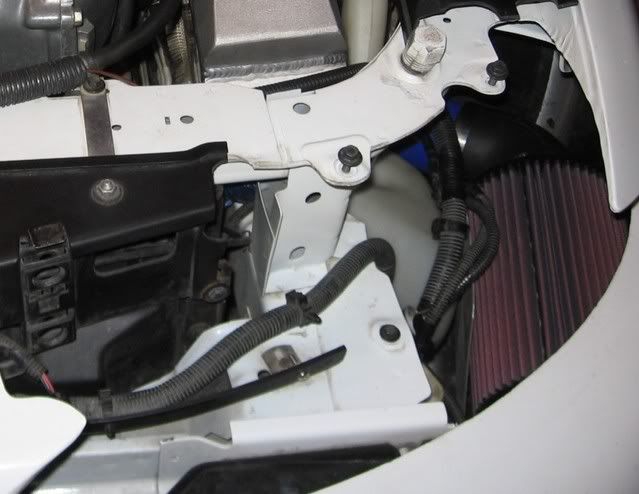

At WOT in 1st gear (worst-case) I tested the ported LS1 MAF with no upsteam tubing and still measured about 0.5 peak in. Hg vacuum between the TB and MAF. I'm betting a stock LS1 MAF with screen is going to be twice that.
After connecting the tubing going into the fender, without the filter, I got just under 1 in. Hg vacuum, and the total CAI , filter + MAF was almost 2 in. Hg. This is almost a 6 % loss of flow, therefore power loss.
The filter is a K&N # 1796, 6 X 9.5 in., mounts horizontal, just under the headlight. And that is the biggest sucker I can fit in there. This might be the best I can do with the space available.

Vacuum is a measure of pressure drop (below atmospheric), which is related to flow. If you increase pressure, as with a supercharger, you increase flow. If you decrease pressure into a partial vacuum, as with a restriction, you decrease flow.
Yes, the intake tubing is a big part of the restriction. Higher than 3.25 in. diameter will be hard to fit in there, but I'll give it a shot.

If you wanna talk about loss of flow, look into the rubber bellows tubing you have in the intake system.
Yeah, you're right. I need 3.25 or 3.5 in. mandrel-bent aluminum with a tight 90 deg. and 45 deg. radius, or make something out of carbon fiber.

I managed to fit 3.5" tubing through my fender to the air filter, and that is WITH the battery still in it's stock location. Took some time and trimming, but it worked.
