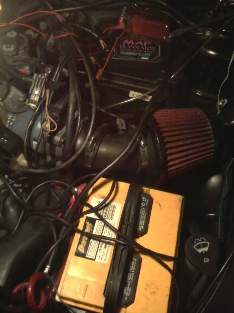

Ok, Here are some before and after pics. This is the intake system that I am using while finishing the tubo kit. I simply removed all the lower air box ducting with the exception of the plastic part with the RAM AIR logo.. I used a three inch mandrel bent piece of aluminized pipe and two, three inch silicone connectors attached to a high flow air filter that you can get cheap at autozone! Inside the pipe is one of those funky air turbines that causes air to spin as it enters the manifold. This combo alone nets me about 10 more horses along with the exhaust mods. You can truly feel the power since the air is already cold. It makes a nice sucking noise as you stab the throttle!For those of you going NA, I would highly recommend this dirt cheap option. This would cost less than $50 in parts.

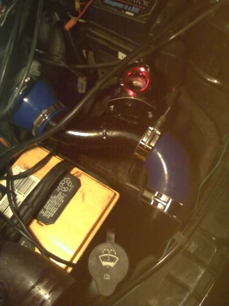

These are the pics of the BOV and final intercooling ducting. I welded and painted this assembly yesterday. Yes, that is an ebay knockoff on the BOV. I still need to tap a hole for the air temp sensor. I should be placing this between the MAF and BOV. You should be able to see the connector hanging a little. I decided to route the piping around the battery because in the end it was so much easier than I expected! I will add T-bolt clamps to the final assembly.

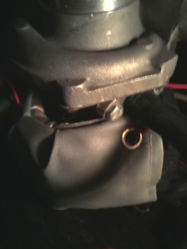

Now everybody knows that rear turbo guys need all the help possible to get the turbo to spool up faster without killing the engine by going with too small on the turbine AR. I read in the LS1tech.com site about wrapping all the pipes and using stock manifolds. An STS technician highly suggested the use of a turbo blanket to keep additional heat in and spool the turbo faster. I got this one on ebay from New Zeland for around $90. This is what it looks like off the car and on it. I will change the wire ties to stainless once I plumb the turbo ! I hope the .63 AR Garrett should kick in about 300 to 500 RPMS sooner!
Just so you know that air turbine your talking about is a scam and does nothing also that intake is considered a warm air intake and will just suck in all the warm air from the engine bay. A fenderwell intake like the one on mpracing is a true cold air intake and is the only one that will give you any decent performance gains.
Umm... I won't go the route of getting another flamesuit, but it does work. I have tested my Firebird with them over and over using a G-Tech unit. They do the same thing as air-raid throttle body spacers. Everyone that has tried them (that I know of) notices the difference. To each his own....
Notice that I said the bottom part of the air cleaner assembly has been removed!
The top part that curves around the battery from the front fasia is still intact. Cold
fresh air is still coming into the engine bay very close to the 3 inch filter. You probably can't see it well, but it is still there. I don't plan on keeping it that way anyhow, but I am STATING that I get more HP with a 3 inch cone filter and intake tubing as opposed to having the stock Ram Air unit and a K&N filter in place. The car accelerates much, much better! I could also easily route some tubing from the filter inlet directly under the front facia if I wanted to.

whats the Horsepower in a box! thing?
I had this tuning device left over from my Firebird. It plugs into your MAF Sensor and help adjust air/fuel curves.
Old 11-28-2008, 08:19 AM   #120
It's a MAF translator. Old style tuning device that basically intercepts the MAF signal and modifies it to trick the pcm into adding more or less fuel. It works as a primitive tuning tool, but isn't the ideal way to adjust fueling compared to actually tuning the pcm, and it can't compensate for different injector sizes.
