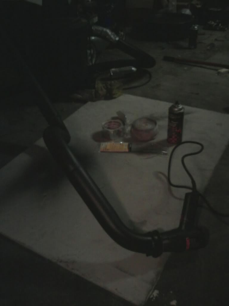

Here is the "meat" of the exhaust piping that I began tonight! It took me almost a whole hour to sand and scrub the rust off this thing so that I could start painting and wrapping it up! I used a can of black VHT, a can of DEI silicone spray, some old exhaust wrap that was leftover from my Firebird project, and stainless locking ties if you can see from the pic. I stuck a heat gun inside the pipe so that it could dry alot faster.
Here is the "finished" product... This is what happens when you run out of exhaust wrap by about a foot. I will finish the bottom part later.
On the car and ready to drive, I have two more small sections of piping to work on which near the CAT and muffler..
And before anybody starts whining about the silver foil on the pipe, Here is the explanation: This is aluminzed tape that will help keep more of the heat in and moisture out! The principle is no different than you baking a turkey in foil in the oven. Even heating (and more of itI just know that somebody is gonna throw some gas on me, but I brought my flamesuit!

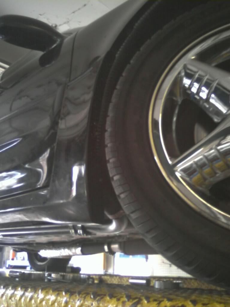

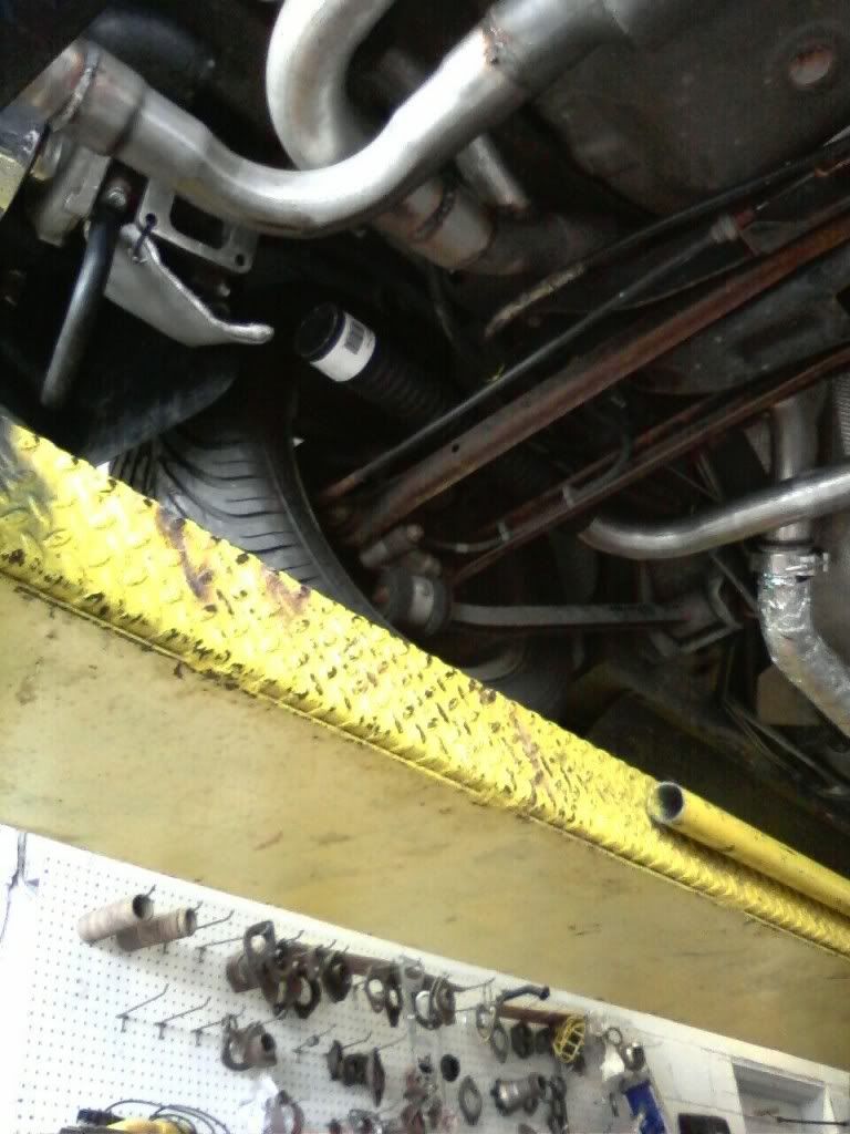

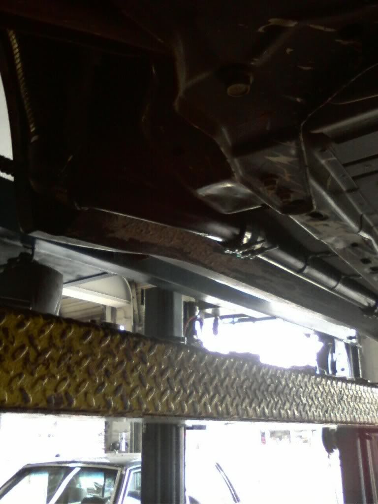

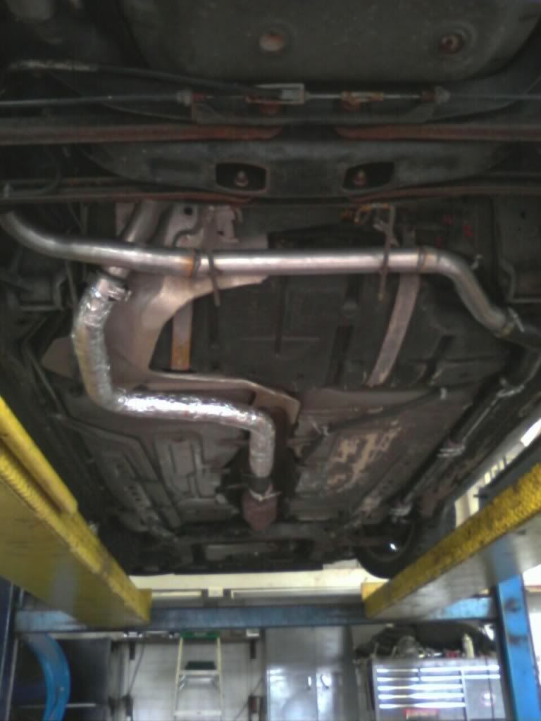

CHARGE PIPING COMPLETE!!!!
Gentlemen, I would have had this finished today, but the guys at the muffler shop are a bunch of SCRUBS! They worked on everyone elses car and only did half of mine. At least the charge pipes were completed. Here is what they cosist of..
Aluminized 2 inch piping, Silicone connectors, flexible exhaust repair pipe (4 feet aroud the wheel well) and 2 inch radiator hoses. I went the cheap route, but I know for a fact that radiator hose (while not reccommended) works really, really good for charge pipe couplers The wanted to go with a silicone piece around the wheel well, but nobody makes one that big. The flex pipe works wonders, and it wont'leak. The splash panels still fit into place with ease. You really can't tell they are there. I will have them painted black like the rest of the car in a little while... Enjoy the pics...

Cool.... So your not going to have any problems with bottoming out?

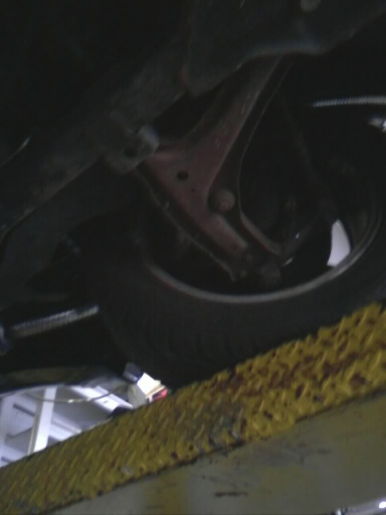

Absoluetly zero! The only way to damage the charge pipe will be to back the car off a curb while turning the wheels... I would have to be a complete retard to hang the car up like that. I was pretty much amazed (so was the welding tech)
at how completely unnoticeable the kit was. If you look at the last pic you can see that the rubber hose goes over the control arm (or axle I think). We took turns moving the chassis up and down on the lift to make sure that no moving parts would damage the charge piping...

looks like "stock". good work man, im anxious to see how well this works

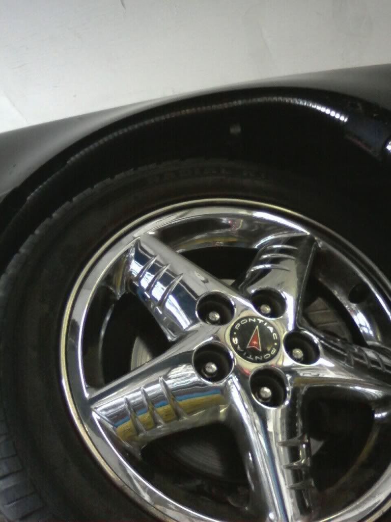

That is my whole goal! I already know that it will work, but I am hoping that it will work as good as the rear turbo kit that I had on my Firebird. I had so many exhaust leaks and the kit bottomed out o just about everything. Funny part was that the Firebird would still haul ass.
On this project, I took my time, made many, many calculated measurements, and I have been driving the car consistently to ensure that the hot and cold parts do not interfere with any aspect of daily driving. There are zero leaks so performance should be up to par with a standard STS turbo system that you would shell out $4 grand! Performance wise, I am hoping to get similar numbers and times as this guy here:http://www.thirdgen.org/techboard/po...unt-turbo.html
As you can tell from his last few posts his system was upgraded with meth and intercooling. After I finish my system I will get to a dyno sometime in January.
I was wondering that too. Or if he'd have cornering issues. But, I guess he made sure everything was going to be clear.
How'd you make sure that the piping wasn't going to show in the wheel well?
Real easy... I placed the flex tube high up in the crevice of the wheel well, and I attached the splash guards so that the fitment could be verified. I had the welding tech tack the pipe to a small bracket and then he placed a small breakable
tack from the bracket to the metal part of the well. I can now move the pipe into position (if needed) and drive a metal sheet screw into the bracket so that it will hold in place.
Right now there is no vibration or contact of the pipe against the well. I will send you a pic of what I am referencing so that you can see it better...

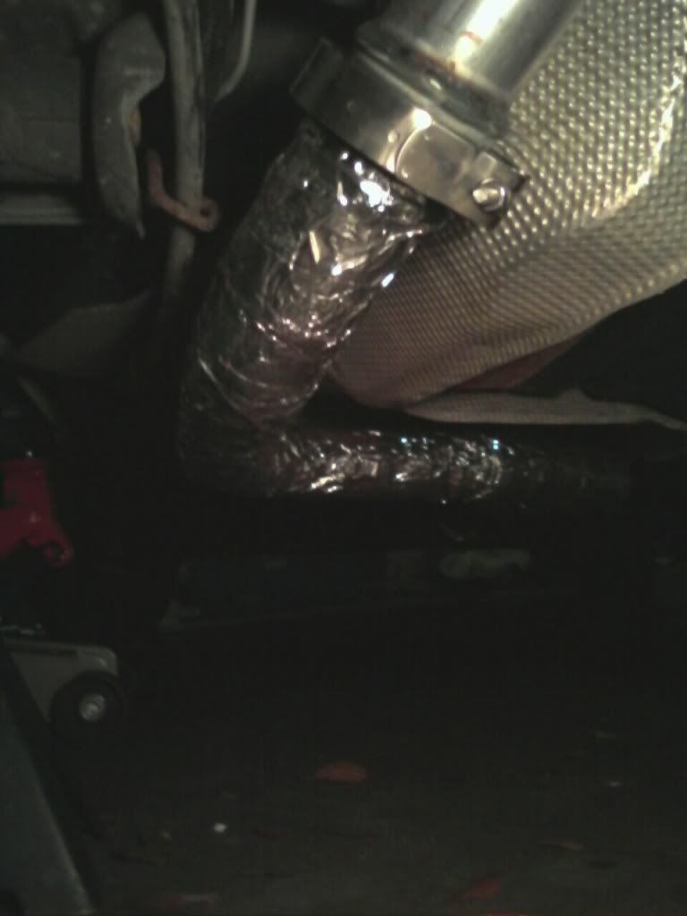

Here ya go!
I left this one out from yesterday somehow....

the project is looking very good. That's the same way I have planeed my rear turbo setup. I just order the mandrel pipes for the charge pipe. At first I was thinking about using the flexible exhaust repair pipe like you did but that will affect the performance of the turbo. I had the aluminum intercooler pipes welded last week (the pictures I post it before) I want to minimise the amount of silicone couplings on the turbo.
Yeah, I am sure that the flexible section was not the best choice, but it will
definetly hold bost, and it was a quick decision. Are you going to have one special
made or are you going to weld up pieces together?
