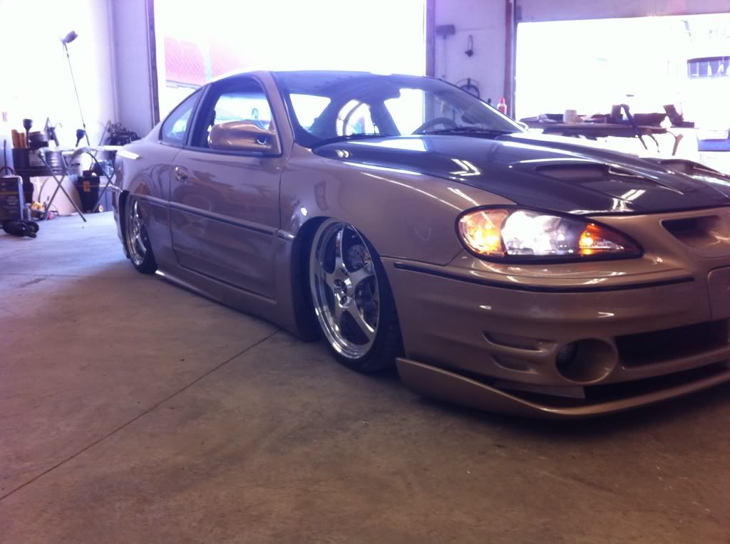

Ok the kit has been on for 3+ years and about 15-20k miles Possibly more miles I have not kept track of it. 2 things to really keep track of. As Soon as the suspension is put on get it aligned these springs will knock that alignment way off and you could ruin a brand new set of tires in a month. Dont ask me how I know
Second after 2-5k miles redo that alignment as these springs will settle and your tires will start wearing out fast.
I initally put the 255's on because I had to get a replacement set of tires fast, and cheap and a guy was selling the staggered setup off his 350z or some such car and the price was right so I grabbed them up and I loved the way the tires filled out the large gap in these wheel wells, so I decided to keep that look and no rubbing ever. I would not suggest 245/40/18's because it will change your speed but 255/35/18's would work and keep your speed very close to accurate though I am not sure how the tires would work up front I doubt there would be rub but I have never tried it.
Or better yet go with 245/35/18 that will have your speed off by less then .2mph
Ok I put the new sway bars on and decided to try the 255's up front, they fit fine no rub and the traction is very nice. I will most likely put the 225's back up front and see if there is much difference but let me tell you the cornering with those wide tires and sway bars is amazing.
Im thinking about goin to 255/35 on mine when i put the bars on, currently on eibachs/gr2s and have run 235/40s without issue on 8 inch wheels. What offset are your wheels, i am goin to have to look mine up...i cant recall.
Old 05-22-2012, 12:49 PM   #253
they are either 8" or 8.5" wide wheels, I dont remember atm the offset is 48.
With 255's you are probably going to want to ditch those GR2's for some AGX's... if you can find 'em. I'm in the same boat and looking for some myself. Even with sway bars and stiffer springs, stock dampening is not enough, and with tires that wide and with that much traction you are going to need more dampening to control body motion during cornering.
