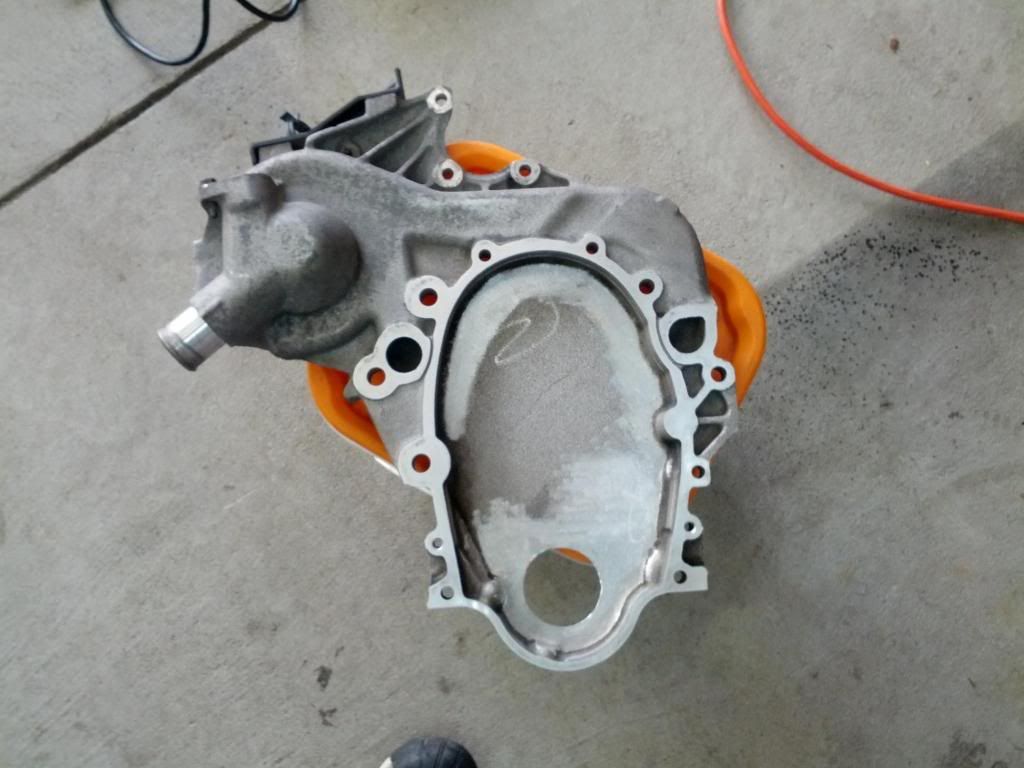

Well I got the timing chain cover modified and installed today. Wasn't to bad it just took time making sure that the chain wouldn't rub the cover anymore.

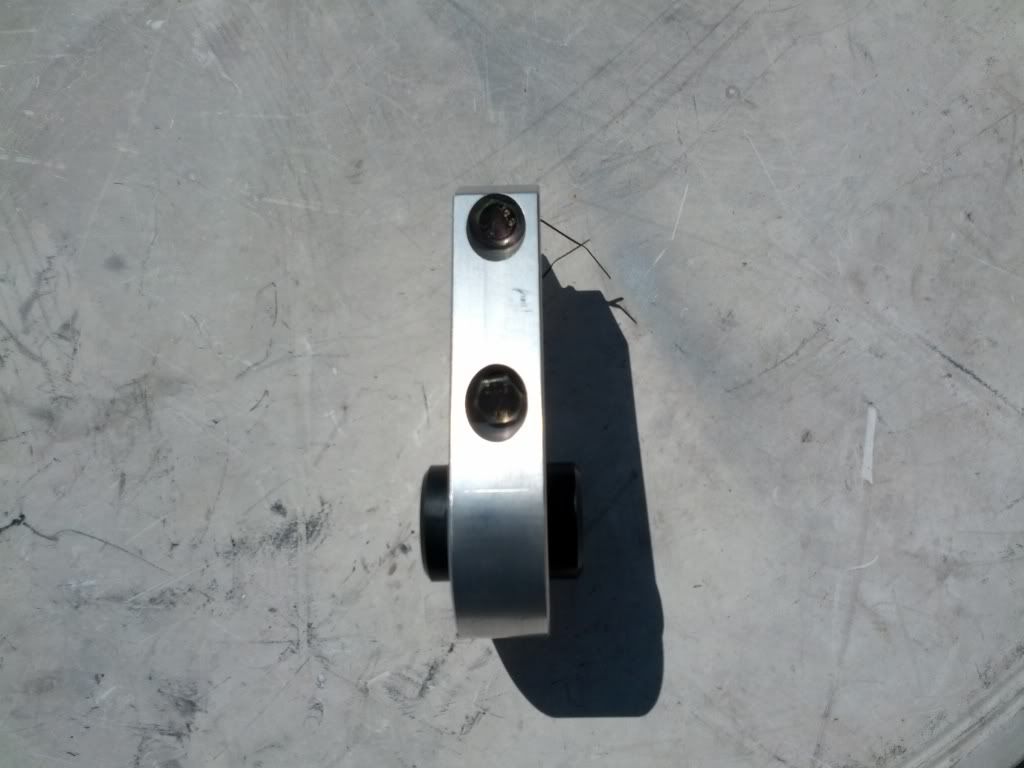

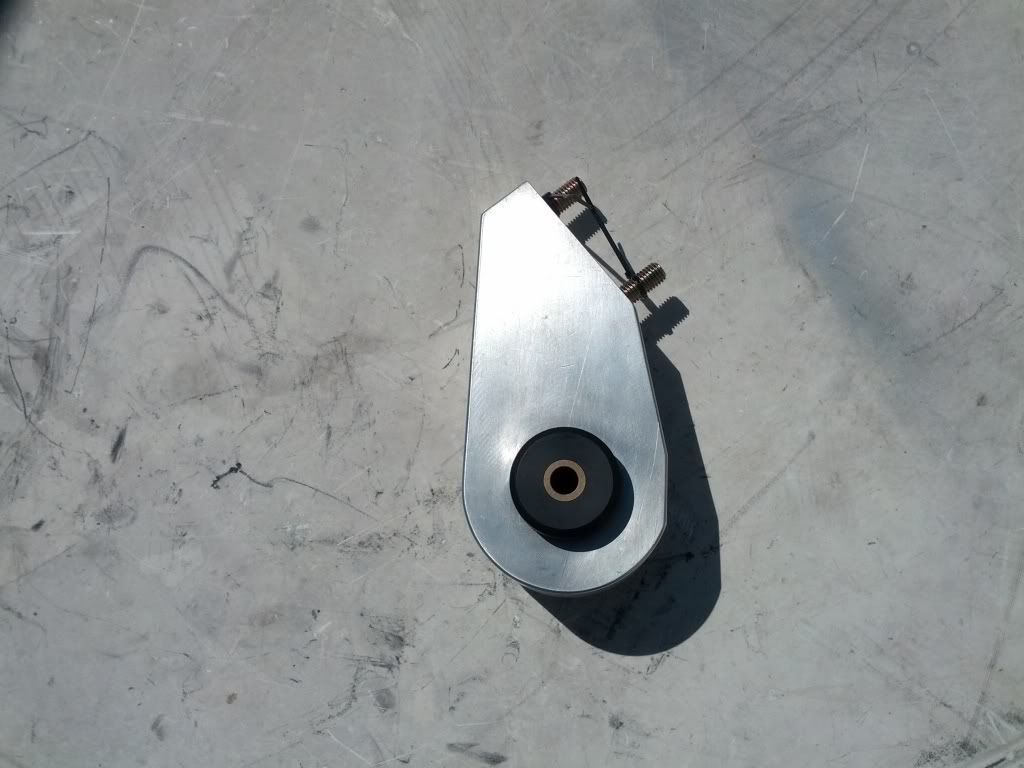

Here's a pic of some of the trans mount.
2002 Grand Am GT Turbocharged
Old 04-21-2013, 04:12 PM   #139
ive seen it on his site but not a real photo, thats really nice.

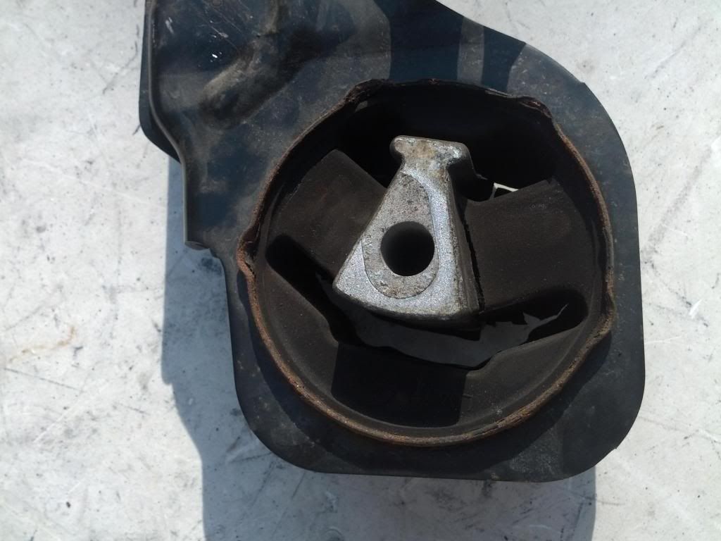

Luckily I bought a new trans mount. Mine was completely destroyed and I didn't even know it.
Heres a pic of the two side by side.
