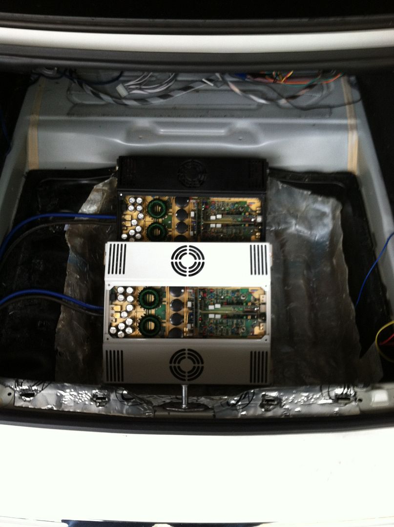

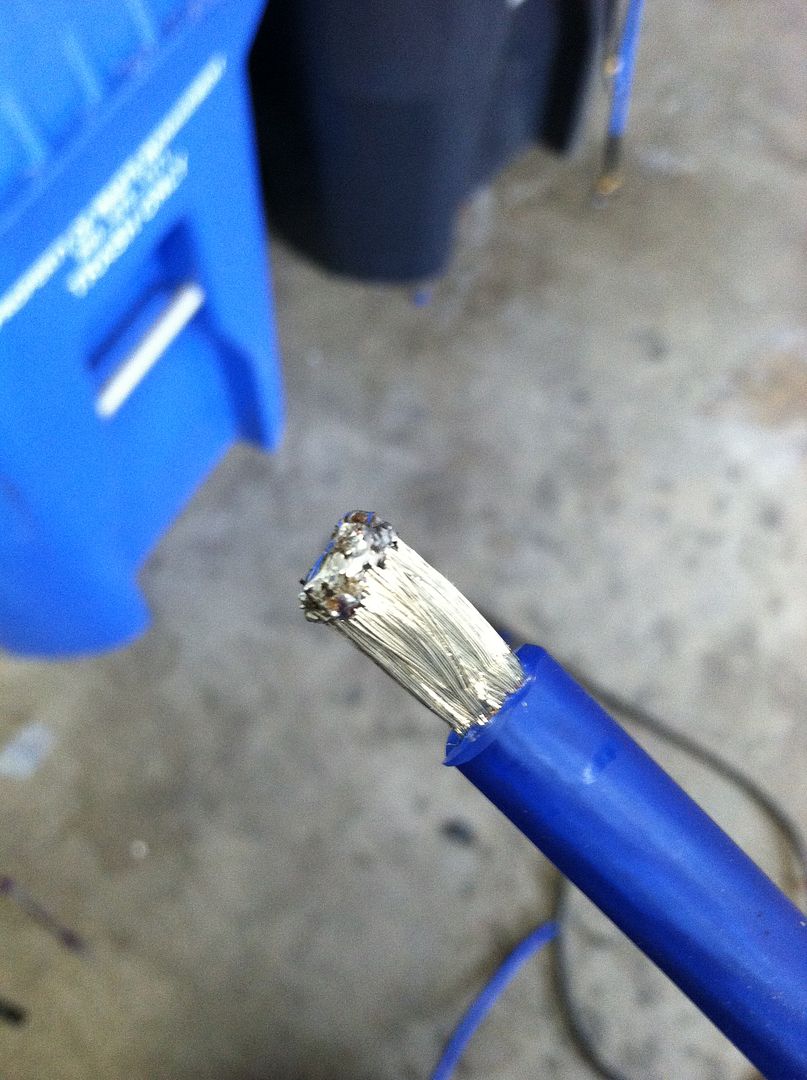

So Phoenix gold suggests soldering the tips of the power wire to avoid frayed strands from shorting the amp. Good idea.

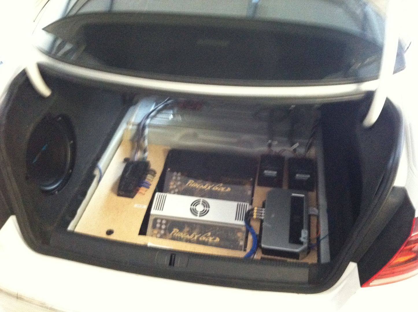

Here are the amps now with power wire connected (I know, nothing special)
And now with the cover on again. I got all RCAs made and connected (notice the line driver has all 4 channels used).

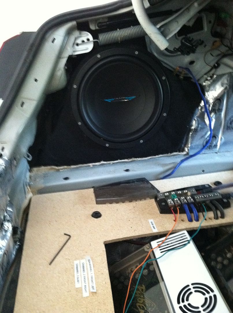

So I swapped my old school Phoenix gold sub for an image dynamics IDQ12. It's more efficient Ina small box and it's brand new. Also I opened up that side panel to let more sound through. I'm working on a grill for it but that will be last of my thugs to do.
So I wired up all of my stuff and got it running again. I also updated the software on the ms-8.
Tonight. I plan to get the main beauty board done. I still would need to get the inner two beauty boards covered and cut. This is a serious process going on here... I'm finally in the home stretch.

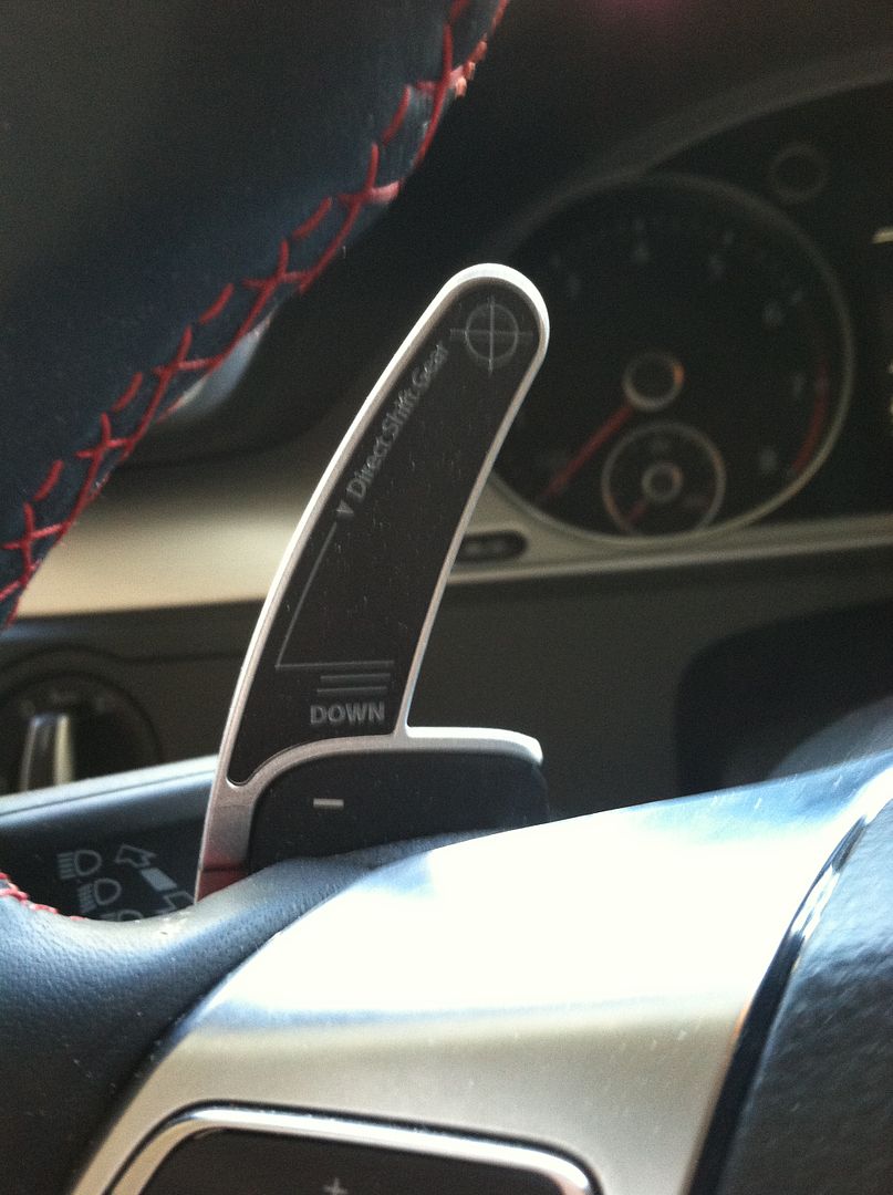

Also, not stereo. Related but I have paddle shifters. Problem is the paddles are small and it always forget I have them so I got paddle extenders. They make them in carbon fiber and other colors but I chose a style that matched factory style...

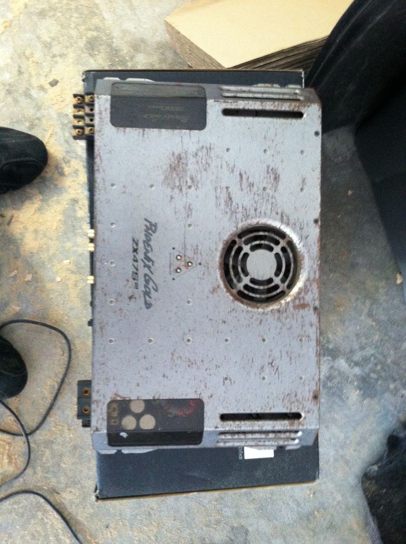

And lastly, I got another amp. This one is going into e collection when Im done restoring it. I got it for $40.

paddle shifters are so fun to play with, but I see how you'd forget about them, they looked little.

No that's how I bought the amp. The zx475ti was prone to rust because of the lack of finish on it but the ti475 (the next generation) had a finish and didn't rust.

Nope. I'm getting it powder coated. I am debating on either a copper look and renaming it ZX475cu (obviously cu is the atomic symbol for copper, and that would replace the it which is for titanium) or the other idea is to do black chrome. I'm still a ways away from any of it as I need to restore it to working status first. It needs new capacitors and maybe more. Before I even touch it I have another amp to finish that is going into my install.

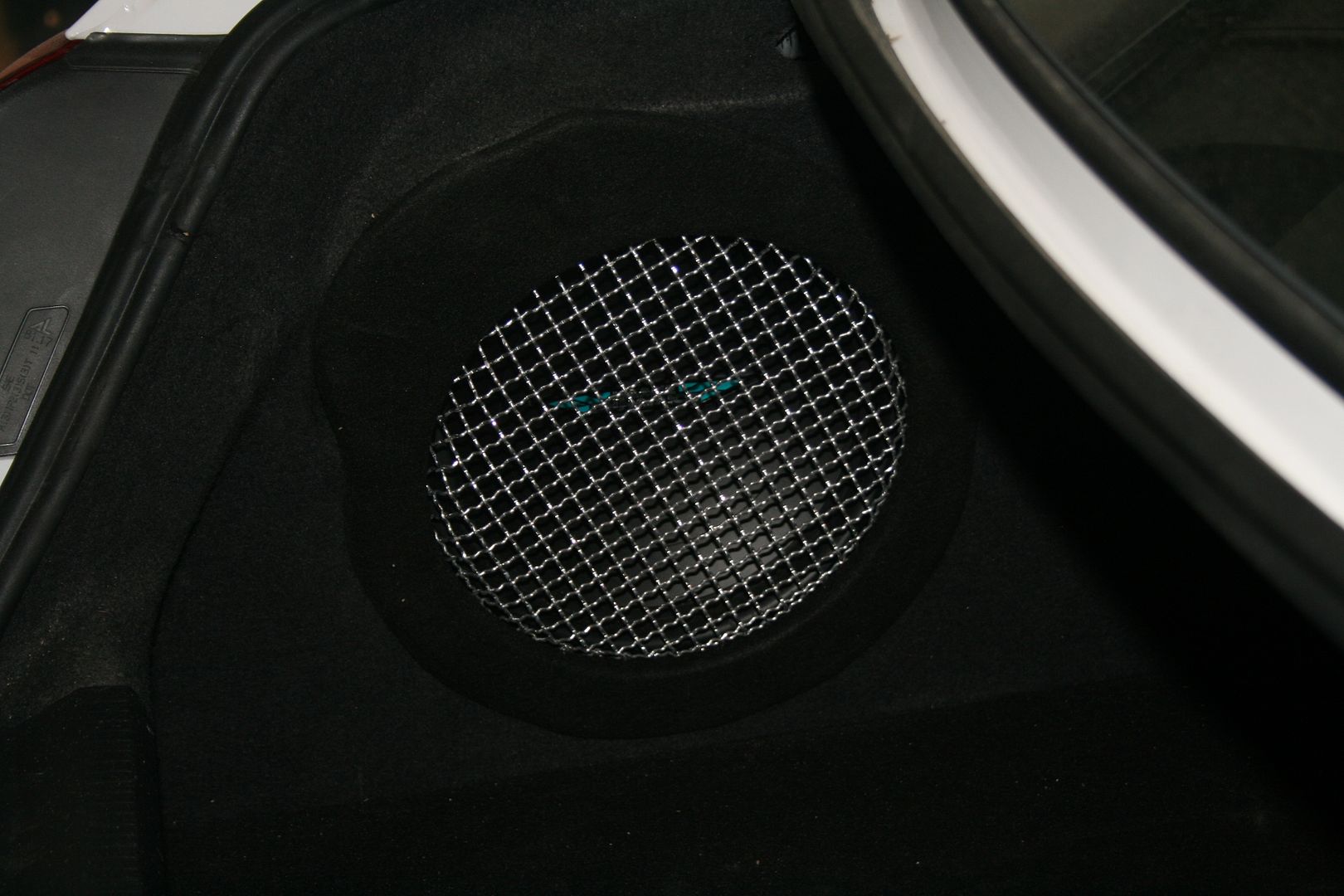

I've been making very slow progress on this as of late. I am working on the subwoofer grill but I have not yet decided on how to finish it. So far I cut the piece of 1/2" mdf out, routered out 1/4" from the back leaving a lip where it will fill the opening, and I left a groove at the bottom for a tongue and groove fit to hold it partially in. I then buried two magnets in the top and I will secure matching magnets behind the panel to hold the grill in place.
I then used my plunge router and the jasper jig to make a hold. Now, I can secure grill material inside the hole and cover it all in grill cloth for a stealth look, or I can cover the wood part in black material and make the metal grill material visible and allow the sub cone to be seen through it all.
Either way..here's a few pictures...

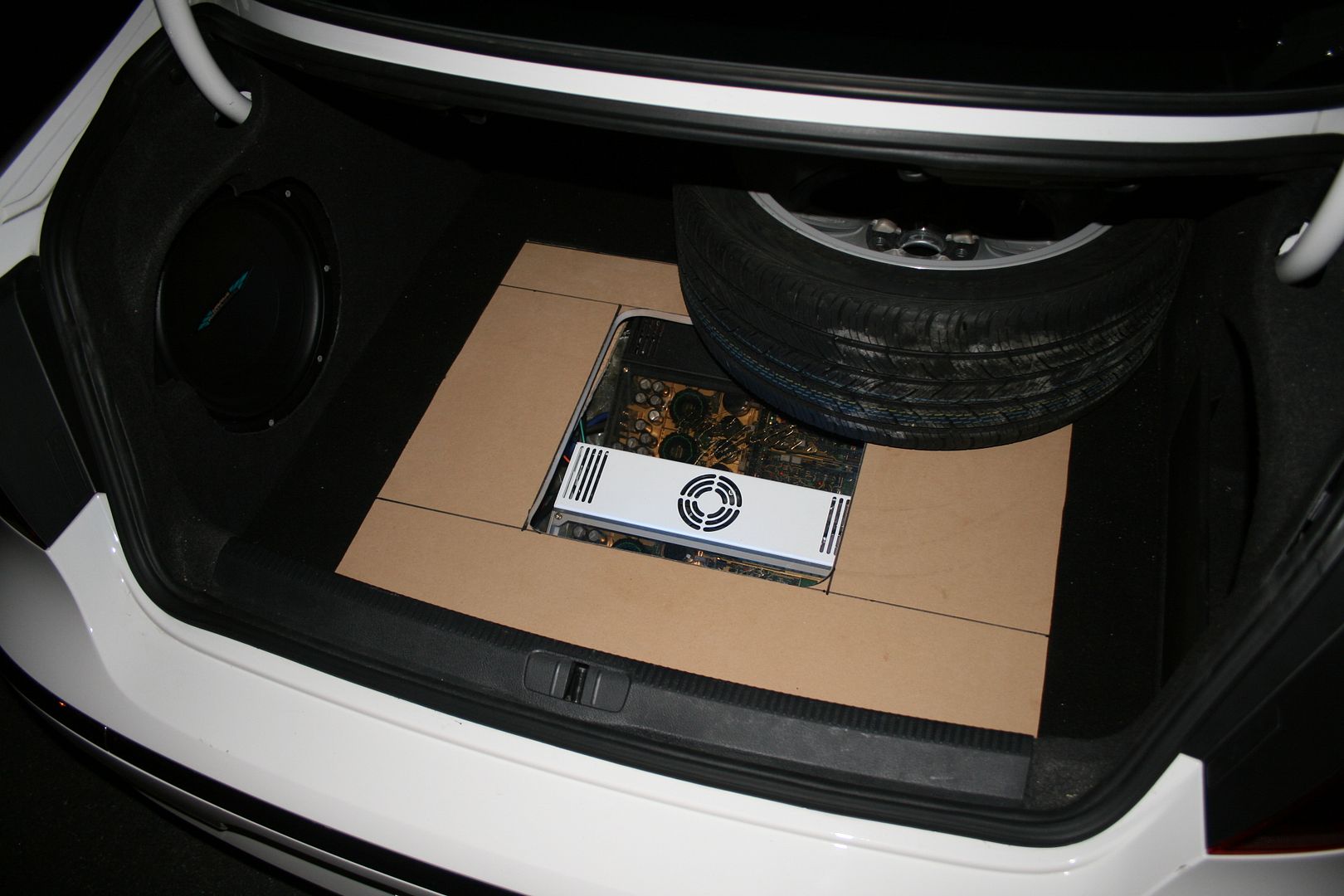

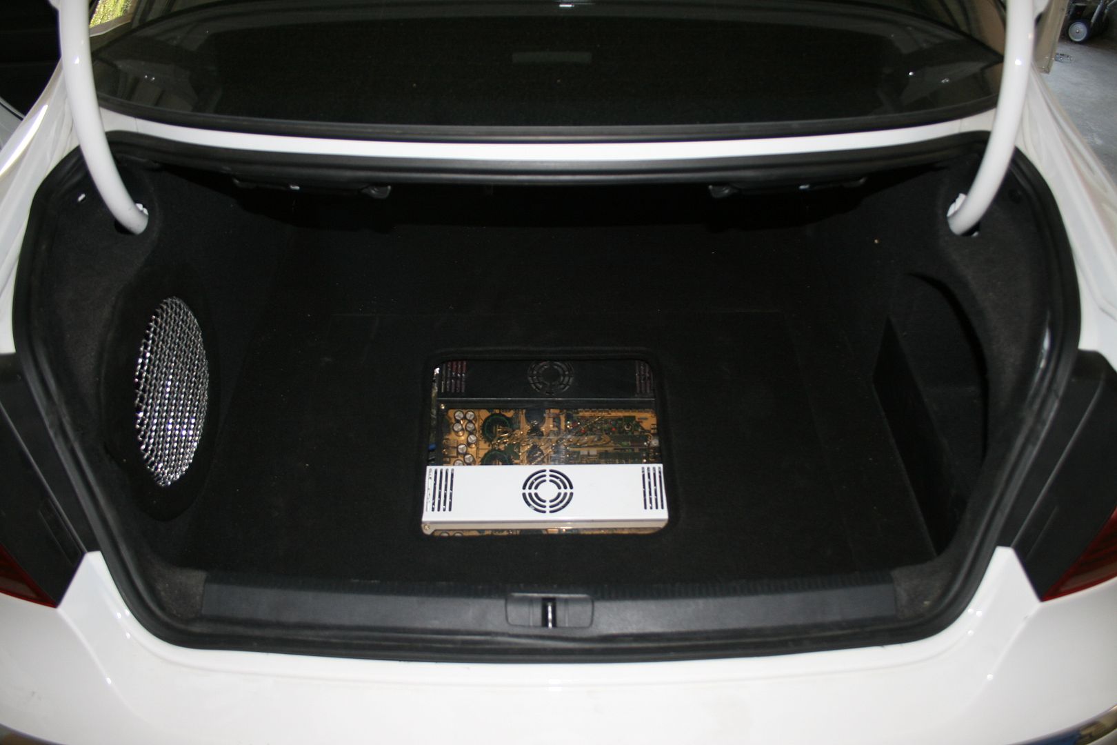

Oh, and here's an update of my install. Almost done...
