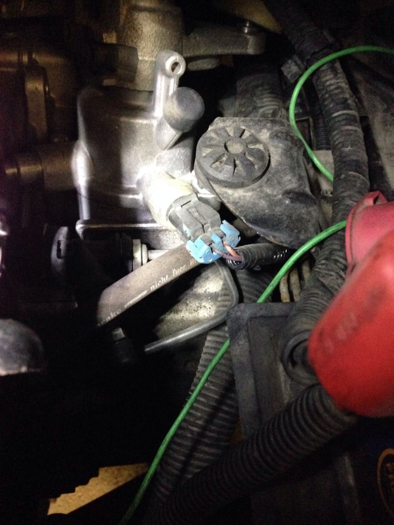

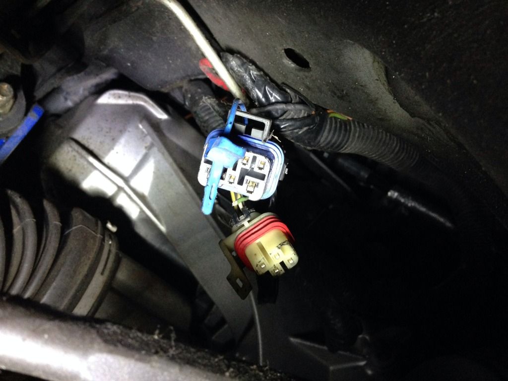

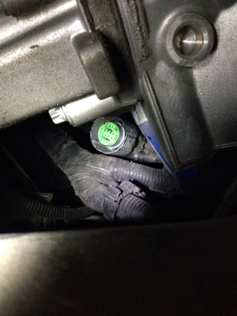

Old 09-29-2013, 03:43 PM   #74
Okay i have some pics for you guys on what plugs are being used for the F40 and what plugs are not being used.
Dont mind the wires showing, i pulled off the electrical tape that was covering everything, and the green wire you will see is to my Oil pressure gauge. That will also be cleaned up when i upgrade to AEM oil and volt gauges.
Here are the plugs i have found so far not being used. First pic is on back of trans, second is on top near shift linkage.
And it looks like a red and black wire was added into the harness, goes into the fire wall, not 100% sure what its for yet.
And heres the plugs being used.
pics seem to be huge, but you can see all connectors very well!

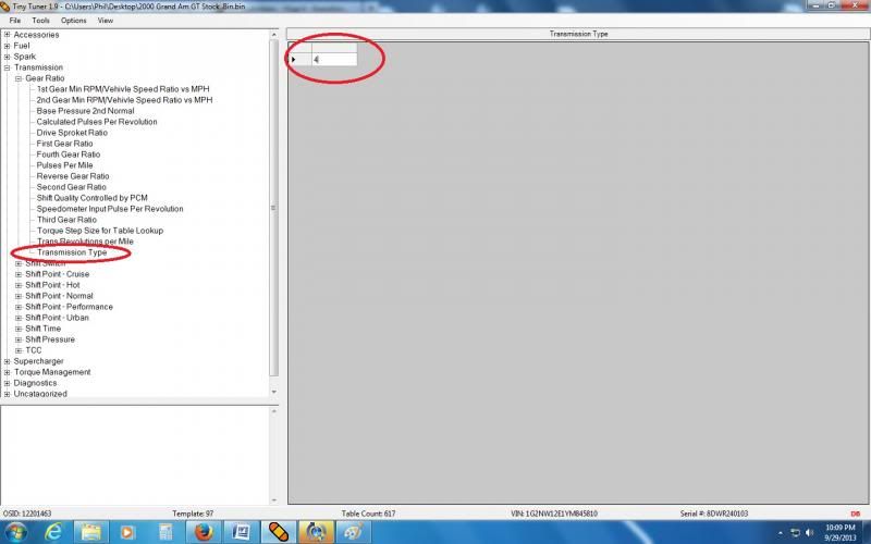

I would be interested in seeing a copy of the .hpt file as I have both DHP and HPT programs. I am curious to see what happens if we were to change the transmission type to manual via tiny tuner. http://www.hptuners.com/forum/showth...-type-variable
If you want to give it a try, I can change it and send you back the file.
