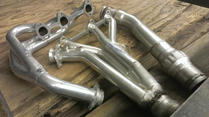

Vehicle: '05 SC/T
gregraisbeck Gettin' there
Glad the headers made it safe.
